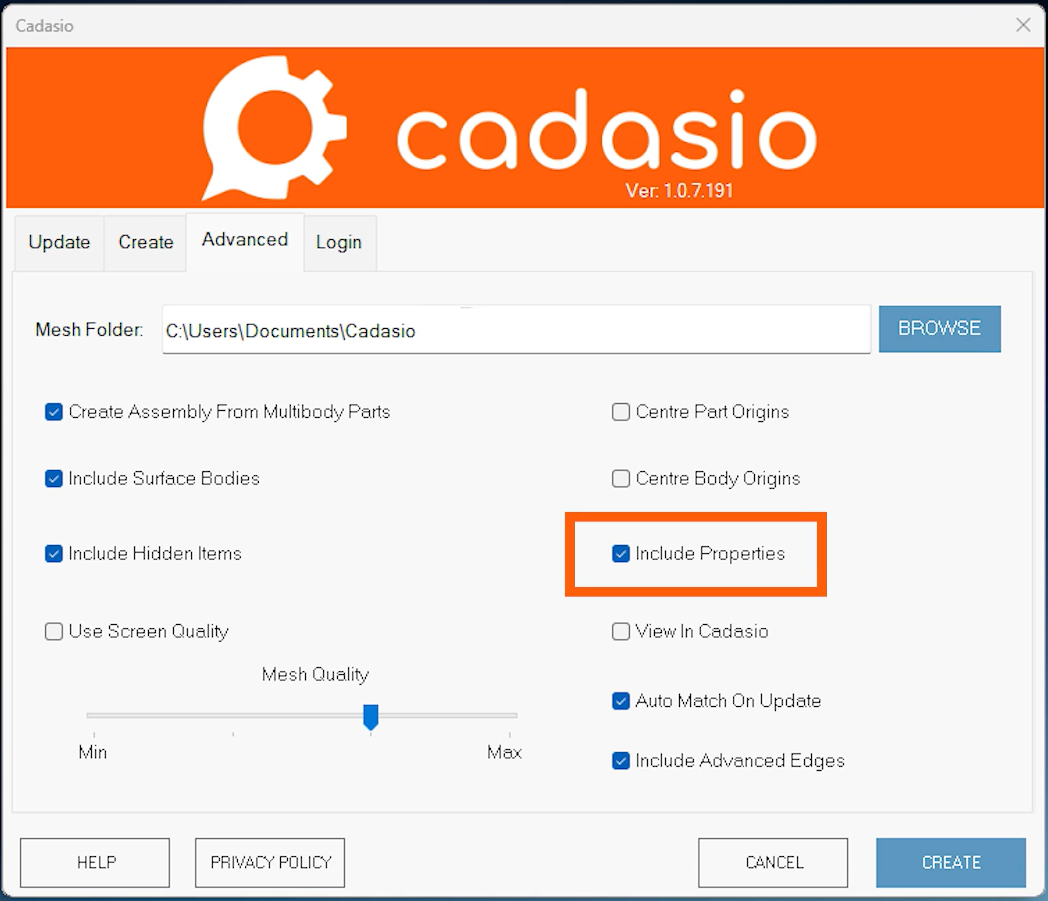

Uploading Meta Properties from CAD
Every Cadasio CAD add-in includes an option to upload Meta Properties when creating or updating a project.
When this option is enabled, any properties applied to your CAD files are automatically transferred and linked to the matching objects in your Cadasio project. This ensures that your project starts with accurate, up-to-date data from the source CAD model.

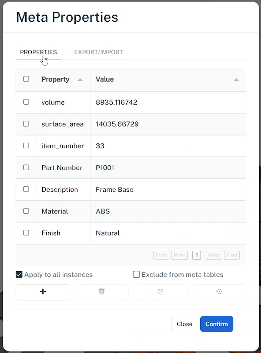

Viewing and editing Meta Properties
Meta Properties can be viewed and managed directly within the Cadasio Designer.
To access them, select any object in the scene and open the General tab. From there, choose Meta Properties. You will see a list of attributes that were pulled directly from your CAD system.
Existing properties can be edited at any time, and you can also add new custom properties directly within Cadasio. This is useful when additional information is needed that was not included in the original CAD file.

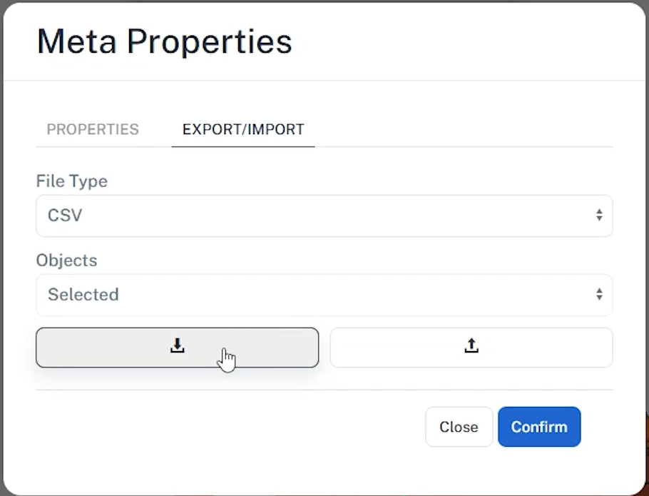

Exporting and importing Meta Properties
Cadasio allows you to export Meta Properties as either a CSV or JSON file using the Export/Import tab. You can choose to export properties for selected objects only, or for the entire assembly.
This workflow is ideal when you need to update many properties at once or add new properties in bulk.
When you open an exported file, you may notice some column titles enclosed in square brackets. These are system properties used by Cadasio to correctly map data back to the right parts. These fields should not be modified.
You can safely add new columns for additional properties, such as a Finish property, or edit existing values. For example, you might standardise a material value by changing “6063” to simply “Aluminum”.
Once your edits are complete, upload the file back into Cadasio. Any modified properties will be updated, and new properties will be assigned to their corresponding objects automatically.

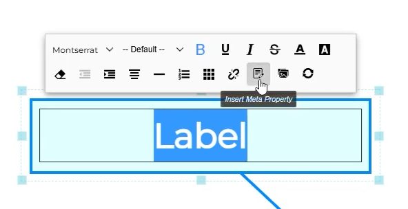

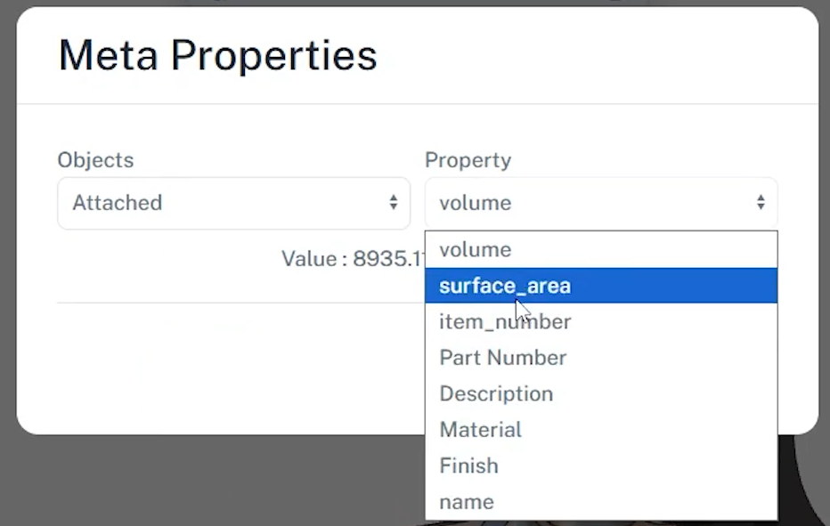

Meta Properties can be used to populate columns in tables, making it easy to create structured, data-driven layouts. They can also be inserted into text markup items.
When inserting a Meta Property into text, you can choose the source of the data. The property can be pulled from the object the text is attached to, the nearest assembly, or any specific part you select. This flexibility makes it easy to display the right information in the right context.
