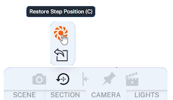

Each step in Cadasio stores a saved camera position. While editing a step, it is common for the camera to move away from this saved view.
To quickly revert to the step’s saved camera position, open the Camera tab and use the Restore Step Position option. This returns the camera to the position that was saved the last time the step was updated.
For an even faster workflow, you can use the C keyboard shortcut to restore the saved camera position instantly.

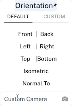

If you regularly need a specific angle, or want to reuse the same viewpoint across multiple steps, creating a custom camera is the best approach.
Press the Spacebar to open the orientation menu, position the camera as required, give the camera a name, and click Save.
Custom cameras are stored in the Custom tab. From here, they can be applied to any step in the project. You can also update or delete custom cameras at any time, making it easy to refine your standard views as a project evolves.

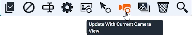

Once a camera is set, either as a custom camera or a manually positioned view, you can apply it to multiple steps at once.
Open the Step Manager, select the steps you want to update, and then click Update with Current Camera View. This saves the current camera orientation to all selected steps, ensuring a consistent viewpoint.
